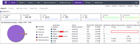

My Netsight/Purview are running v6.2.0.199, and there is no any Application and Network response time since custom fingerprint 4days.
In the screenshots, one is custom fingerprint setting , the other one is Report->Dashboard result, you can see the customer fingerprint was created on 5/13, but there is still data of Application and Networks response time until 5/17.

Report -> Dashboard
8f1a533fdba94e268be079b14c02a276_RackMultipart20150517-11359-1f2dooe-custom_fingerprint_dashboard_inline.png

Hello Joy, I would also add that it depends on what view your looking at. Can you send attach a screenshot? (Note this is a public forum).
Note that if looking for this in report form, it may take an hour or more to become part of that, and if looking at the flow views, the flows may already be in use by some other transactions, and will not report until they time out.
