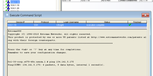

‎06-24-2015 04:46 AM
Well, I run my script on a A4H124-48 switch with success. But the same script throws this error on another switch with same model:
Missing parameter for task : CLI_LOGIN_PROMPT
I can access the switch with the same ssh credentials. So what should be the problem?
