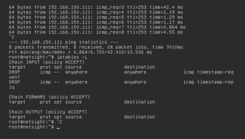

Here is the firewall for the netsight server.

Typically when pings don't work and tftp is not going through there is some kind of firewall issue. Could you try disabling the firewall temporarily on the netsight server to see if this resolves your issue?
