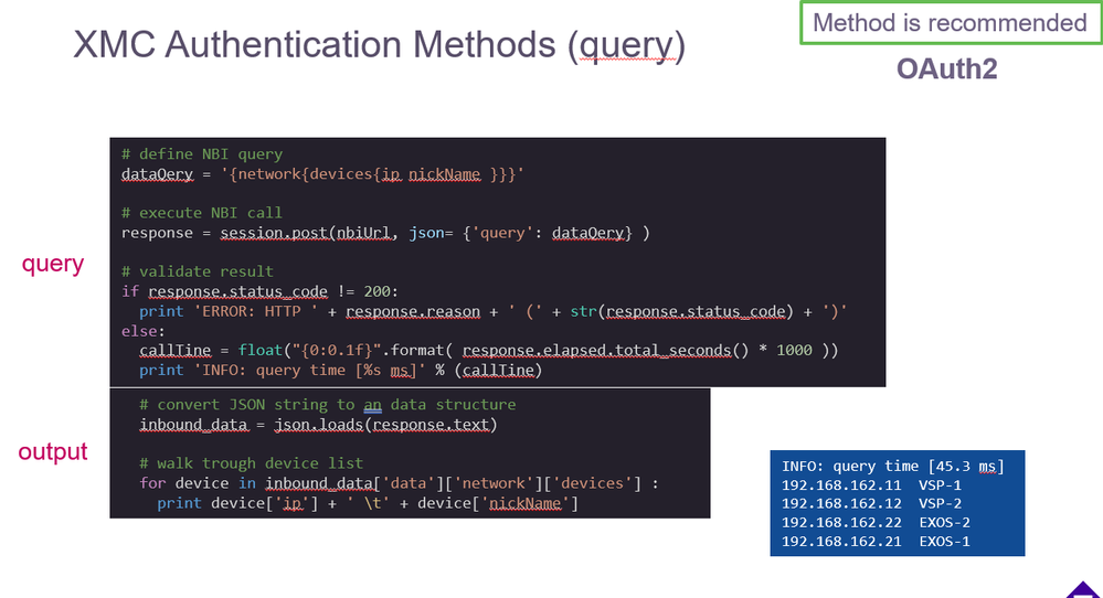

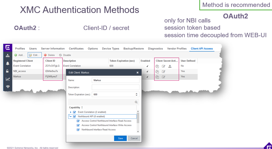

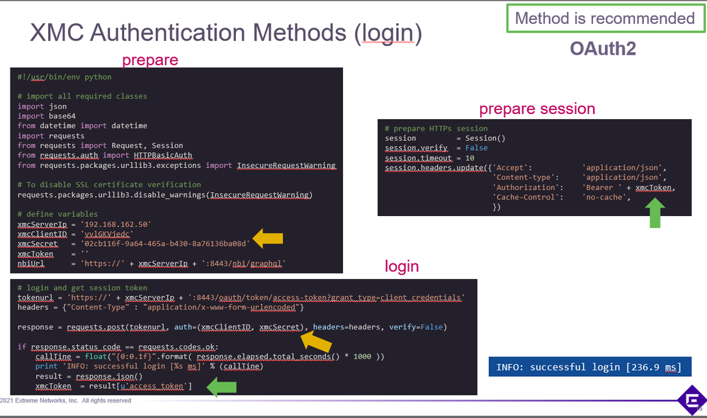

Markus_Nikulski
Hey guys,
you should not use the regular user login for API authentication. Is better to keep is separated using the
Client API. Is a bit more pain for managing the login and token. But is much saver.
Thx
Markus
