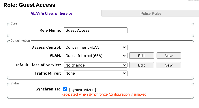

The issue is the VLAN ID is different in each location. That means the contain to VLAN is different for the same roles on each controller.
The ‘sync’ on the EWC has been removed for those roles between each of the controller because the VLAN ID’s are different.
The problem is this is creating an issue with policy because you have the same policy with different configuration on each controller, so the policy verification is failing and I can’t get EWC and Policy to sync with that configuration.

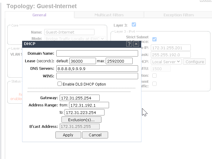

The same subnet range is being used in both locations, the EWC just splits the DHCP scope into two, one half one side one half the other side. This means the topology cannot be sync’ed either.
That said the failover works really well, albeit not completely straight under the hood.
The guest traffic bridges at the controller to esa1, which I believe is VLAN’ed to a dedicated internet firewall in the network somewhere. I unfortunately do not have much detail on this, other then so long as I drop traffic onto the guest internet VLAN, supply the default gateway (firewall) to hosts via EWC DHCP scope, its good to go

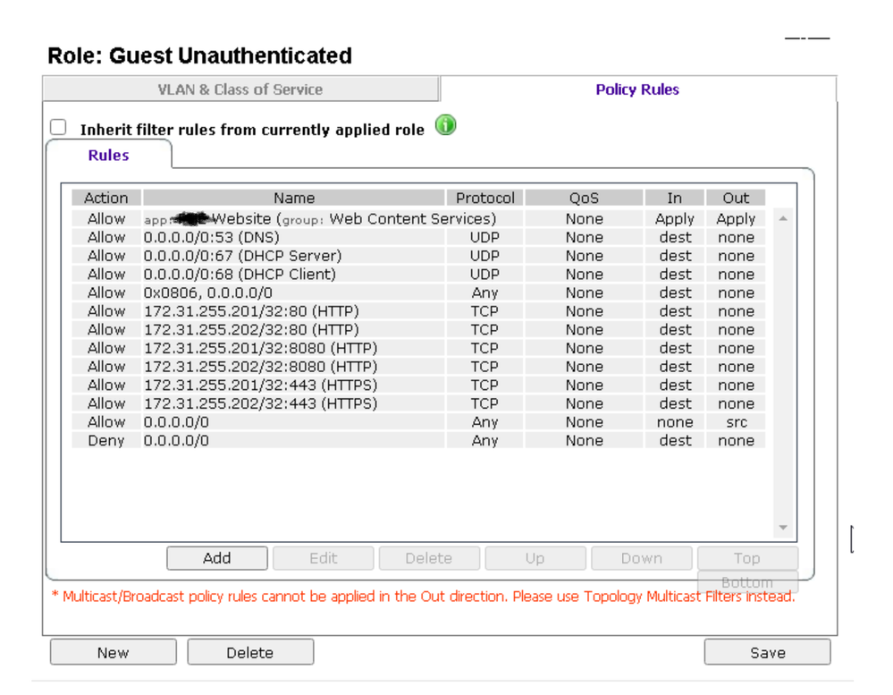

I’ve provided some screenshots, so hopefully the above and these provide the detail you need, let me know if you need anything else. The screenshots are taken from one controller but they are pretty much the same on both sides except the topology, the other side has a different L3 IP (172.31.255.202) and the other half of the DHCP scope for the same subnet.
In the screen shots the Guest polices are now in sync, as although the topology for the guest VLAN shows tagged on this controller the other side wasn’t. That meant I could just change the ID to be the same. Now they are in sync.
