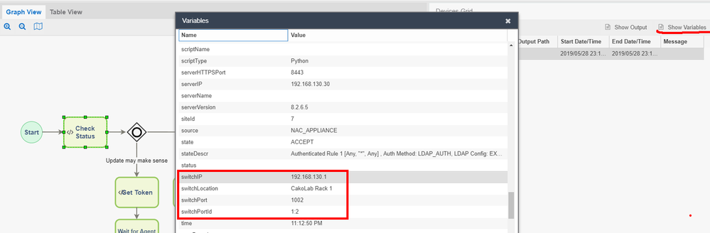

If you run the workflow by executing it against the switch then the workflow does have access to emc_variable deviceIP.
If you run it from notification engine then the workflow does have emc_variable switchIP.
Check the list of variables here. if the workflow was executed you can see variables available for the workflow in the results window...
Regards Zdeněk Pala

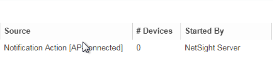

Our specific situation is that we try to get a workflow going after plugging in an AP which generates a notification.
This works when we run it in XMC but fails when we test it by plugging in an AP. The workflow runs but fails.
The big difference between the 2 variable results (XCM test vs real) is the fact that our devices variable stays empty whereas the devices variable in the test shows the switchIP.
I tried forcing the switchIP into the devices variable, but no difference, this looks like it's enforced (because it is system-defined?).
Any idea why this would be happening? Or do you have a way to get some debug level logging?
Thanks in advance,
Lennert

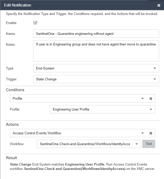

When I execute the workflow by notification engine I can use variables in the workflow.
Example of Notification:
Example of variables:
Example of python code to check those variables:
if emc_vars["oldstate"] != emc_vars["state"]:
Hope it helps.
Z.
Regards Zdeněk Pala

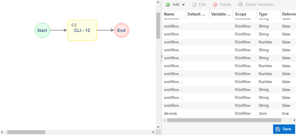

Thanks for your answer. I think I get that.
Our notification looks just like yours and works.
But the problem lies with the fact that our workflow doesn't find the compatible devices.
In this instance our devices variable is empty.
This comes from a workflow with only a CLI activity in it.
Do you have an idea why our "devices" variable doesn't automatically get our Summit switch, or how we could enforce that?
Thanks in advance,
Lennert
