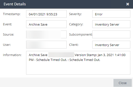

I use TFTP as file transport method.
In Alarm and Events is only a timeout Event.
Yes there are about 70 Devices witch use the same Backup config and they work just fine.

01-05-2021 08:04 AM
Hello Nico,
what file transfer method are you using? What do you see in Alarms&Events (select Inventory)?
Do you have other devices working? Do the use the same file transfer method?
