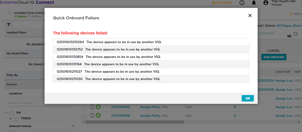

Bought some aerohive ap250 but get a “The device appears to be in use by another VIQ” error when adding to my account.

The device serial numbers I am trying to add are: 02501603210264,02501610130752,02501610130854,02501610131194,02501610211027,02501610211030

hi thai,
that sucks! the seller of the APs hasn’t removed the serial numbers in his redirector or ExtremeCloudIQ instance.
maybe @Sam Pirok can help you out?

Yes, thank you. I informed my buyer, they added it to cloudiq ok

Thank you for your patience here @thaihv3, those devices should now be free to add to your inventory. Is there anything else I can assist you with?

Thank you for those serial numbers, I have contacted the original owner for those devices as well. I’ll let you know as soon as I hear back.
