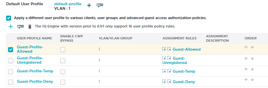

And no, i didn’t setup the user groups like in your screenshot. I created a UP just like all the other UPs, so it just enforces the vlan id of our internet vlan.

Ok so sounds like the SSID has been set up if you can see it “green”. So “Enable Advanced Guest Access” in this has been enabled. Have you also set up the separate user profiles in the SSID as below, with each Advanced Guest Policy assigned to a user profile/VLAN?:
Next, in the guest essentials, ensure you’ve got the onboarding policy set up and that you’ve assigned a splash template to that guest SSID & location.
Also another requirement is to ensure that the AP is assigned to a location, and has been updated with the new ssid configuration.
