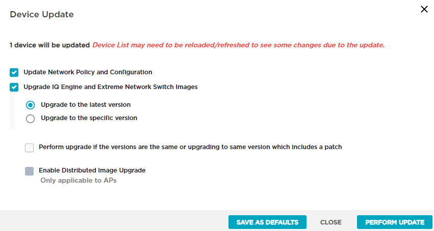

Is it possible to schedule an upgrade of a switch within XIQ.
When I go into  manage and select the switch, and click on upgrade I get the following without an option to schedule the upgrade or reboot.

Thanks for your patience here, the option to schedule an update or reboot for a later time is unfortunately not available for all devices right now. There were some issues with this feature and some models so we had to take the options out for the time being. I’m sorry I don’t have better news for you here.

When is this expected to return? I'm seeing the same problem with APs recently. This used to be something we could do.
