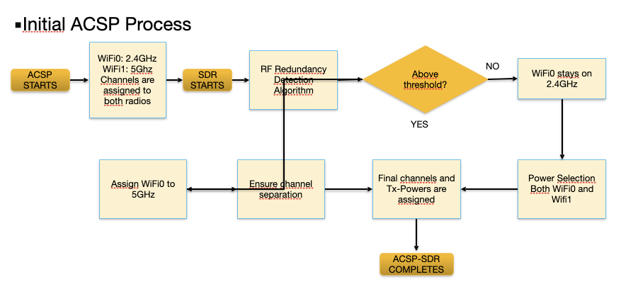

- APs coordinate with each to determine the best channel and power levels for the environment using the Aerohive Channel Selection Protocol (ACSP).
- With ACSP, each AP reports their channel, power, client loads, FCS errors, neighbor APs and more to their neighbors to help APs coordinate which channels and power levels to select

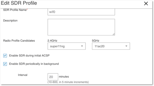

If you wish change the time of background scan you need to create a SDR profiles, there you can change all about ACSP.
