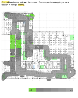

As others suggested, you should collect data with a wifi scanner (simplest) or a full wifi survey.There are 25 20 MHz channels in 5GHz, so 15 AP per floor is not a lot.
What's the configured channel width? You may have co-channel interference if 40 or 80 MH chs are used.

Appreciate the help Jan. Channel width is 20. We still seem to have channel interference. We do have an ekahau, just learning to use it. Going to run another survey tomorrow but this I guess shows it's a problem. So why isn't it optimizing the channels? Should we be manually assigning them?

We're not using DFS so we only have 9 channels. Extreme support seemed against that but maybe we'll give a try and test. This is from a problem spot, in the corner of our building with a bunch of apartments nearby. The screen print is from Ekahau which we're still learning. Looks bad! Thanks Jan!
