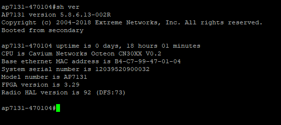

I just tested AP7131 v5.8.6.13 VC and no issues with onboarding to XIQ:
The error that you provided is due to NO valid DNS entries on the AP.

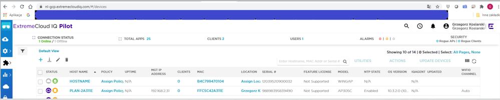

Hi Ovais. Thank you for your answer, I'm glad you are helping me. Of course, this AP is added to the XIQ account - screenshots below.
Regards
Greg

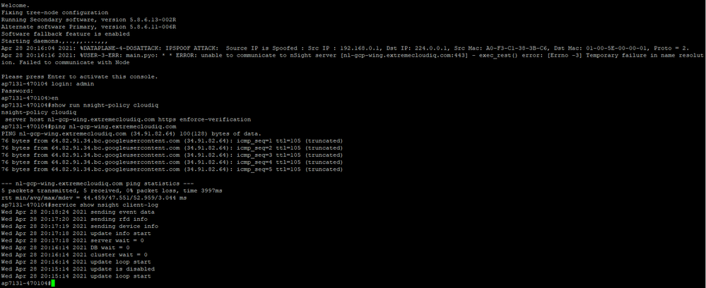

Your “Service show nsight client-log” output looks good and the AP should be sending stats to the XIQ instance. That error message could be due to an initial communication/handshake.
Could you confirm that you were able to add the AP to the XIQ using the VC APs MC address (without hyphens) and now the data is shown?
Regards,

Hi Ovais. Thank you for helping me. I did as you wrote. I do not understand why AP displays an error communicating with the extremecloudiq server when starting up. After logging in, this server responds to the ping. Below is a screenshot and the current startup-config.
