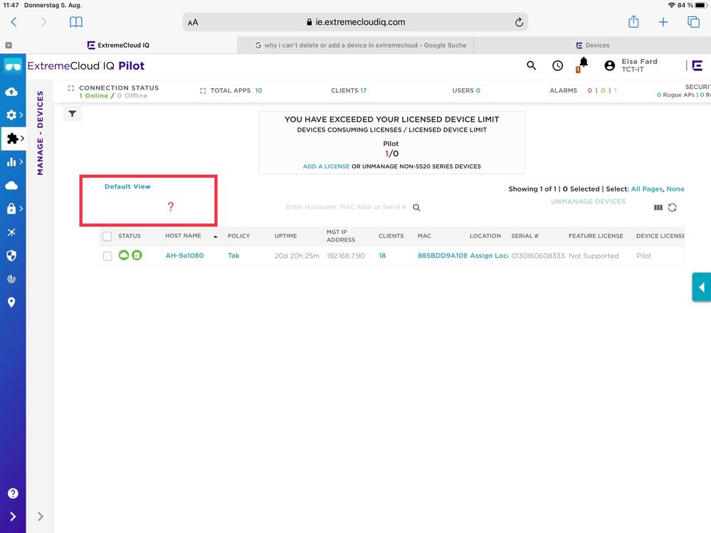

You can’t directly delete because of the licence limit being exceed. If you select the AP > Unmanage devices it will remove the licence error. Then you should be able to delete it after.
