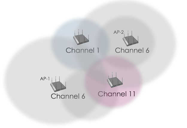

That’s correct, the issue will surface only when you have APs in the hearing range of each other while using the same channel. The following diagram should help visualize that; here channel 6 is the cause of CCI since two APs can hear each other on channel 6 which will cause the APs and their associated clients to compete for channel access.

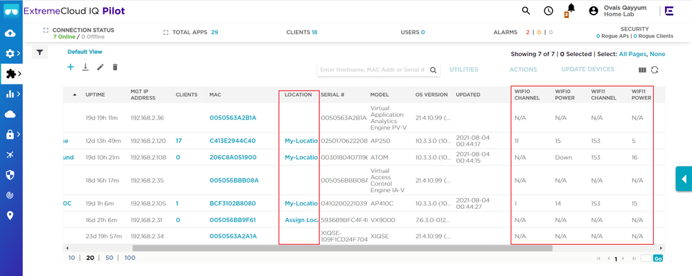

“I would recommend you take a look at the current channel plan to verify if you have APs that are close to each other and have been assigned the same channel. You can use Network 360 (if a floorplan is configured and AP are mapped) to check the AP locations, channel and power information. Another way could be to use “Devices” screen and sort the APs based on Hostnames if you have them by locations and then check the radios stats:”
