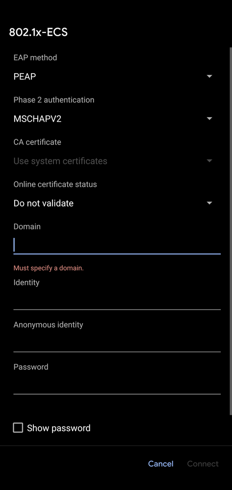

I created some users and had their credential sent to me but they won’t connect.  When I use PEAP my mobile device asks for a Domain.  See picture
When I have set up 802.1X networks with my own Radius server it never asks for the Domain.  I tried to use extremenetworks.com but that didnt do the trick.
Any ideas?

Domain- Typically you’d use the domain your end users will be coming from, but if you can elaborate on where you’re seeing the domain section, I can try to be more specific.
