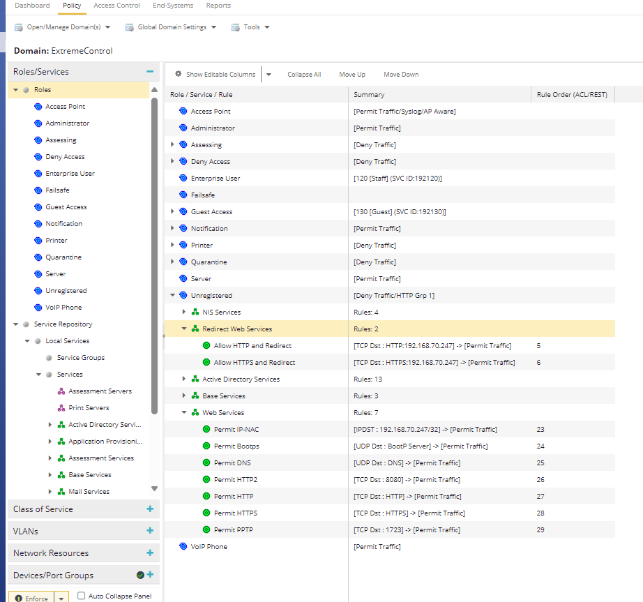

01-15-2025 08:29 PM
hi James-san
Upon checking, I found that a similar configuration is also present in the rules on XIQ-C.
I believe this configuration was pushed via policy enforcement from XIQ-SE/Control, which manages XIQ-C.
Or is it necessary to create a separate rule for proper interpretation in this case?
As far as I remember, if a rule is created within XIQ-C, it gets overwritten when enforced by SE.
Even in this case, should I create the rule on the XIQ-C side?
