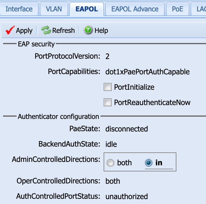

One trick I used for your use case (printers with MAC auth) is to adapt the eapol port settings sending the following radius attribute in the answer:
FA-Service-Request=WOL
This keeps the broadcast and multicast go through even when the port is not authenticated.
That helped on several cases.
You can also do it manually with the following setting in the EDM:
I would suggest also to keep the firmware of the printers up to date and if possible configured for 802.1X
