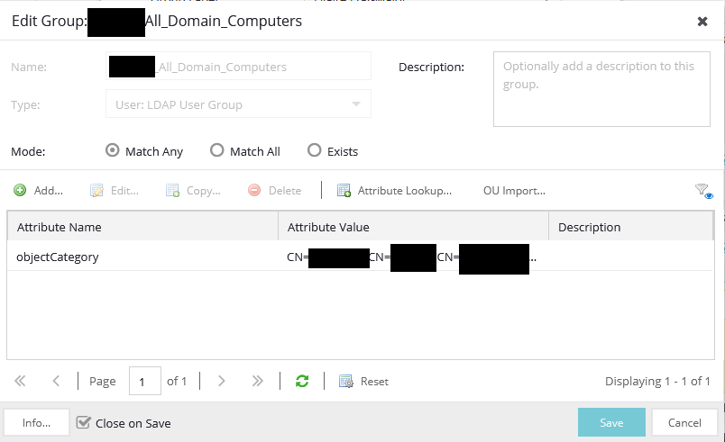

The first rule I must match is down below. It's for host authentication (username field is used).
Here some anonymized screenshots :

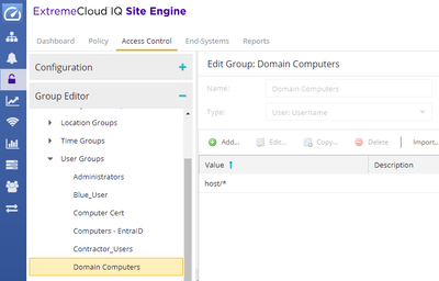

10-19-2024 12:15 AM
If the PEAP or EAP-TLS is used then you should have name of the computer in USERname. That means you should use USERgroup test. Hostname-based end-system group requires the hostname resolution to be working.

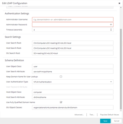

if you want to check LDAP for the computer membership then you can:
1. define LDAP for computers:
2. define AAA rule for computers:
3. user the user rule with memberof
10-19-2024 11:31 AM
Thank you for your reply !
We use 802.1x PEAP MsCHAPv2 😉
We have a similar configuration except for the usergroup.
You use an attribute value "host/*" where we use "objectCategory" as attribute name and "CN=[...],CN=[...],[...],DC=[...],DC=[...]" as attribute value as shown on a previous screenshot.
I made a test by clicking "Attribute Lookup..." and by filling a existing host with the format "host/[...]".
I do have a positive result.
So I think the configuration is alright.
What I did not understand very well is your last sentence : "user the user rule with memberof".
Could you please tell me more ?
In the mean time, we are still investigating the DNS reverse resolution possible issue.
Kind regards
10-20-2024 12:21 AM
The autocorrect has changed "use the user rule with memberof" to "user...". The most common criteria is "memberOf" but "objectCategory" should work also.
I recommend checking the format of the username with the LDAP search. Also Configuration Evaluation tool can help a lot.
