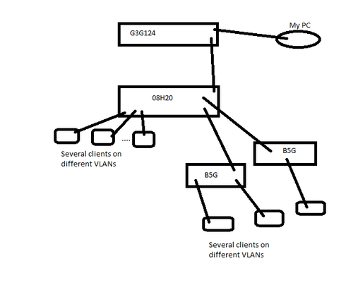

Well, my bad, I did not explain the issue well enough.
8bb66f56a7a7432c864589fd543530be_RackMultipart20161223-91990-xi88mr-topology-01_inline.png
The switch is connected to a G3G124 via fiber port. There are two B5Gs connected 08H20G4. All switches' management vlans are vlan 1. There are also vlan 100, vlan 101, vlan 70 on the switches. G3G is the router for all these vlans.
So when the problem appears;
1. I can ping the 08H20, I can connect to it via ssh and can connect to it via web gui. So vlan 1 through G3G to 08H20 is forwarding and working.
2. But I can not ping or access to two B5G from my PC.
3. I connect to G3G via ssh. G3G can ping the 08H20 but it can't ping any of the B5Gs even their management ip is on vlan1 like 08H20.
4. So I connect to 08H20. This is where it gets funny. Because 08H20 can ping both B5Gs.
If it was a port blocking issue, 08H20 should not ping B5Gs. But it can. The clients that connected vlan 100 can ping each other but can't ping other vlan clients.
I know it is confusing. I am confused. If it was all working behind 08H20 but could not accessible form G3G side I should check the fiber port and connection. But it is not the case so I am really confused. This setup was working for more than 2 years and there aren't any config changes lately. It is always happening after some kind of power outage but does not happen when we power off/on it. I am suspecting some king of hardware issue but I need to find a way to reproduce it.

Bastian_Sprotte
to understand an forwarding issue, some easy steps should be taken,
1. do you have an valid link on the port you have an issue
2. is the port in forwarding or ready or blocking status
3. have the port an learned MAC address
4. is the learned MAC address in the correct VLAN learned
5. is the vlan tagged or untagged defined
6. do you see any port counters TX/RX
You see, if you work with these steps you should have an better understanding where the problem is located.
