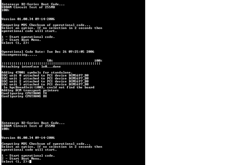

If the B5 presents the exact same message please capture the logs (just as you've done with the B2) and open a case with the GTAC to request replacement of the defective hardware.
Please, make sure to mention the article "In hpcBroadInit:1003, could not find the board" when you speak with an engineer.

‎03-24-2017 02:37 PM
Please find attached the error i am getting. Prior to my original post, i went to option 2 and i did select factory defaults, without any success. Both of the devices have exactly the same output. Any ideas please?
