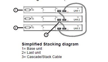

On unit two disconnect the the cable that is connected to the cascade down port - reconnect that cable to the cascade down port on the new unit three. Install a new cable connecting the cascade down port on unit two the the cascade up port on the new unit three switch.
Example of ERS4800 Stack below:
Power the new switch up - be patient on this step. Some times it will take a while for things to sync up.
Verify the status by running the āshow stack-infoā and āshow stack healthā commands. You should now have three switches in your stack. The configuration will be automatically stored on the new switch - you do not need to do that. Keep in mind that the new unit will have all ports in VLAN 1 when it becomes part of the stack so you will need to make your changes from there.
