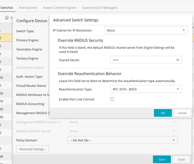

You'll have to add the correct config into the ERS switch for CoA.

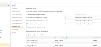

Use this as CoA profile in the advanced window of Control:
Some times you'll have to add the correct OID in the global default engine settings like this:
