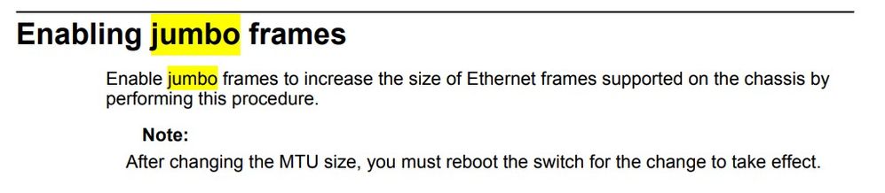

Hi AndrƩ,
I believe that there isnt negative impact in enable jumbo frames, but I dont know all the details of the network.
But, from this "Administration Avaya Ethernet Routing Switch 8800/8600" rel, 7.2 from May2013 doc number NN46205-605, you must reboot the chassis.
Cheers!!
