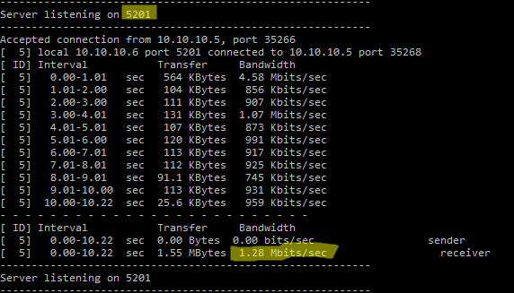

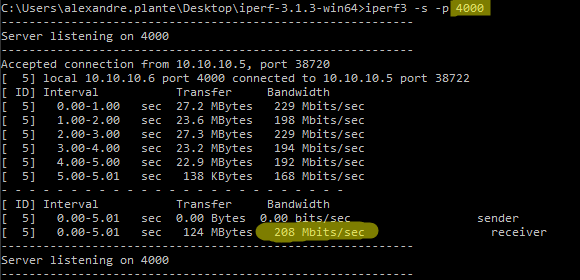

After applying the commands, I ran 2 tests. One iperf3 test on port 5201 (the port I wanted to throttle), and another one on another port which I don’t want to throttle, port 4000. The tests were successful. I did change the committed-rate a few times and the iperf3 tests were all representative of the adjusted committed-rate.
Iperf3 results on throttled TCP port 5201
Iperf3 results on un-throttled TCP port 4000
