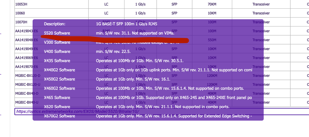

Check out the optics site for 5520 and the 1000BT p/n 10070H
  https://optics.extremenetworks.com/EXOS/
It mentions that the extreme p/n 10070H is not supported on the VIM ports.
TTBOMK Its only supported on access ports for the 5520-48SE and 5520-24X.
