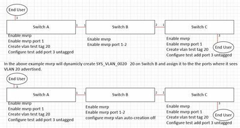

You are looking for MVRP. If you create the vlan on both switches and add it to one active port on each switch it MVRP can dynamically add the vlan to your uplink ports.
8884e69193334f88a86f0716fa8a7a76_RackMultipart20170110-77494-1skn7ch-Capture1_inline.jpg
