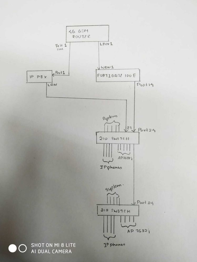

i have two 210 switches , a fortigate 100E device , nine AP7632i and an astTECS IPPBX . i would like to create a network with four vlans in which one is for controlling all other vlans, one is for guest wifi , one is for ippbx and one is for switch management. kindly help me on this.

Hi Tomasz,
First of all i would like say is that i am new to the networking field.
here scenario is that i need to setup a network with above mentioned devices.
| Network | VLAN | VLAN NAME | IP RANGE | GATEWAY/ Controller IP |
| Admin | 10 | ADMIN | 192.168.120.0/24 | 192.168.120.1 | Admin Network, To access all vlans |
| WIFI | 20 | PUBLIC | 172.16.68.0/22 | 172.16.68.1 | WIFI for Guest |
| IP PHONE | 30 | VOICE | 192.168.200.0/24 | 192.168.200.1 | Approx. 30 Uses ext. |
| Management for Switch | 40 | MGNMT | 192.168.230.0/24 | 192.168.230.1 |

What part do you need support with? It might be difficult to help without customer requirements, planned network diagram and so on.
Assuming FG 100E is supposed to work as a router connecting 210s, PBX and APs connected to the switches, correct?
Regarding VLANs, what do you mean by ‘VLAN for controlling all other VLANs’?
What devices do you need help with? What do you have configured already?
210s and 7632s are not EXOS just FYI (wrong product category).
