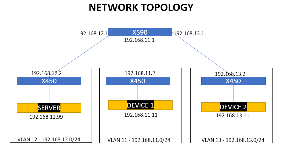

Hello,
We have three VLANs created and devices can reach other devices in different VLAN using ping. My problem is how can I enable multicast and broadcast across the VLAN.
We have a server in separate VLAN with application installed. Server needs to listen to broadcast and multicast on other VLAN. This server can reach the devices through ping and vise versa but it cannot discover the devices on the network.

Hi Stefan,
I already have this command on the switches:
enable ipmcforwarding {vlan name}
But still cannot see the devices (VLAN 11 and 13) on the server (VLAN 12).

03-29-2021 03:02 PM
Hello Stefan,
Thanks for response. Is there any link or document i can look into to achieve this. Also is there license requirement to enable PIM on the switches X590 and X450?
Thanks!
