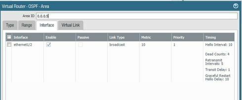

This is the default value in both cases. The Palo Alto is configured to use a broadcast link:

Did you check the usual, like mtu? Is the Palo Alto using also a broadcast link or is it configured as pt2pt?
