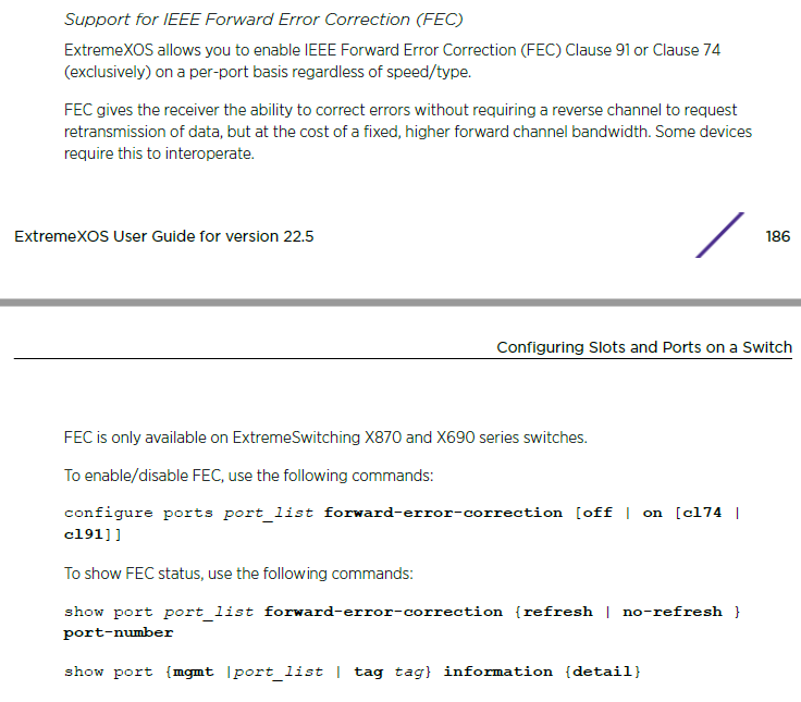

If you lookup the User Guide for 'Forward Error Correction' you will see that it is supported for X870 and X690 regardless of port speed/type. 🙂
