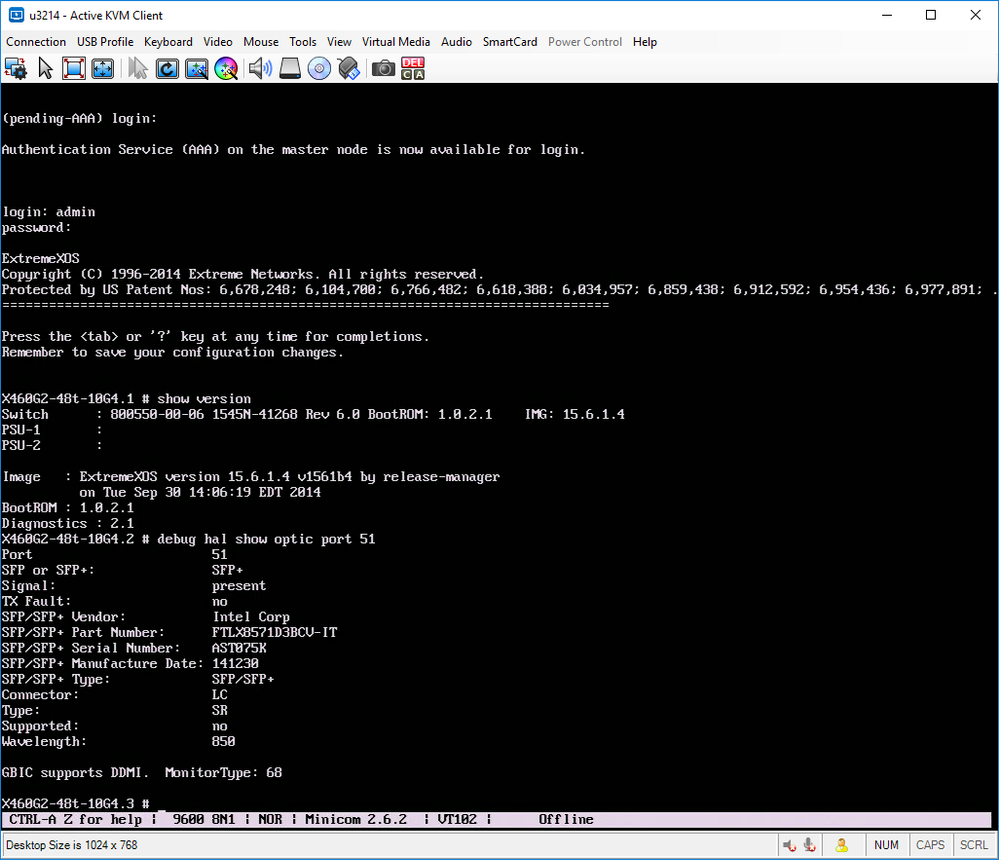

Dear Friends,
I upgraded the firmware to the very latest version. However, it seems that my fiber module is not supported in the latest firmware (30.x). I tried flashing a much older firmware (15.x) but I had the same issue.
Could anyone make a recommendation for a supported X460G2-48t fiber module?
thanks, t.
