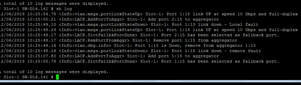

Fredrik, Thanks for your response
I am getting below log on switch, port number 1:15 and 2:15 is in lacp sharing, fallback enabled.
i want to active fallback only on port 1:15, it should not be active on port 2:15, is this possible
port 1:15 has lower priority,
any preemption option  in extreme switch fallback. if port1:15 goes down due to any reason, 2:15 comes up but if  port 1:15 come up again , it should be active in fallback not 2:15

It says EXOS 16.2.1.6 or higher is required. Have you tried something else in the fallback port? One possible cause for the provisioning to fail is if the server disables the port briefly after DHCP has succeeded. Have you looked in the logs of the switch to see if the port flaps after the server has got its IP? Just out of curiosity, you could put an other switch between the X670 and the PC so the port is stable throughout the process. Of course the LACP part will fail, but then you’ll be one step closer to realizing what’s causing the problems.
