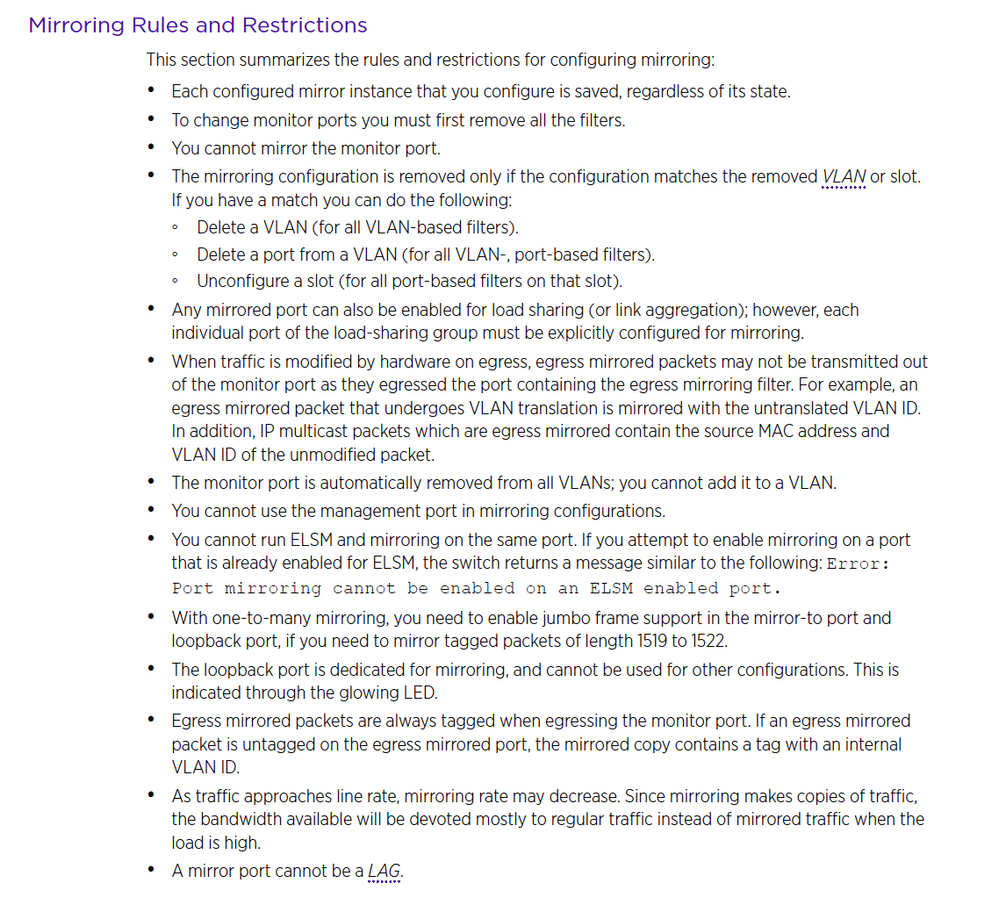

gorn,
Have a look at the point 10 from this screenshot of the doc:
Did you enabled jumbo frames?
Mig
