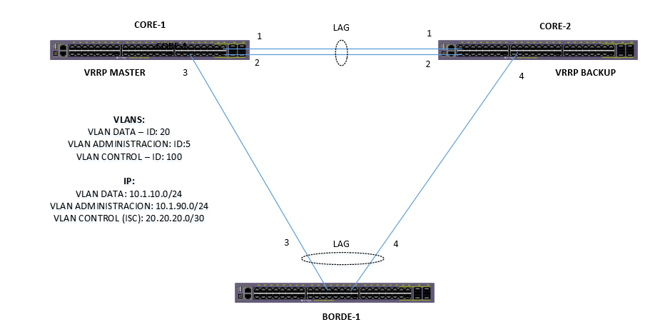

I am currently conducting an operation laboratory for MLAG and VRRP, for which I have 3 x440-G2 switches all with firmware version 22.5.1.7 patch1-3. Having the following scheme:
All links are formed through LACP L2, I have the inconvenience that when I disable ports 1-2 of the LAG, both remain as an ACTIVE / ACTIVE role within the VRRP. According to what I understand multicast packages should be propagated through the MLAG ports (these being 3 and 4) to exchange the information of the roles.

Could you perhaps post the relevant snippets of your configuration?
I’m assuming the port 1+2 LAG is an ISC-style share/vlan?
For each switch, what are the “share” and “mlag” configs?
For each switch which ports are in what vlan?
My hunch is that there may be something in your config that isn’t quite how it’s supposed to be. I have pretty much the same setup, but I have to admit that I also never killed ports 1 and 2 both.
Usually the vrrp propagates itself via MC, there you are correct.
Could you provide config snippets of Port/Vlan assignments and tagging/untagged as well as the VRRP and MLAG/ISC config snippets?

Hello Kevin,
this somehow looks like an issue “by software design”………………………..
Setup alike yours except that I changed the IP of the border device (same vlan Administr. but different subnet, hardly good to troubleshoot).
Now I deactivated the ISC and started to continously ping from 10.1.90.3 to the border 10.1.9.10 (incoming on port 4 of sharing 3).
But all the traffic back (echo/ping reply) goes up the port 3 of sharing 3 which then arrives at the 10.1.90.2 (getting deny/not-found packet back).
I also tested with different algorithms (l2,l3,l3-4) with lacp on and off on all sides. Please bear in mind that usually the “How to config” guides for MLAG and sharing are referring to the algorithm L3_L4 (LACP).
Does not matter in this case.
As well as Backup-Master (Fabric-Routing) feature; Does not matter whether Off or On in this scenario.
The ARPs as well only get learned to the master port of the sharing on the border. Which is okay.
What is not okay is that those seem to always go out on the master sharing port first.
