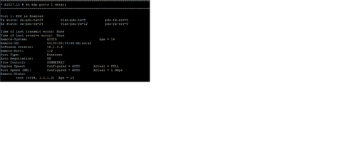

Could you test it after initiating a ping between the switches. There should have been a ARP entry on the uplink for the IP to get populated in "show edp ports detail" output. Below is the sample output from my lab switch:

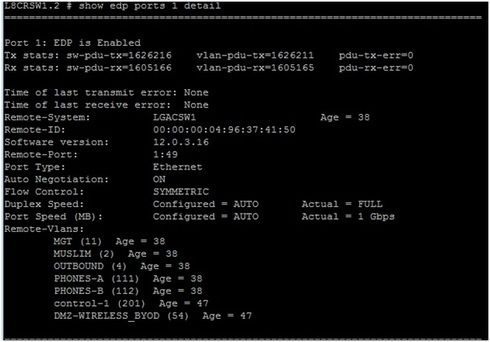

Please refer below. No IP address
