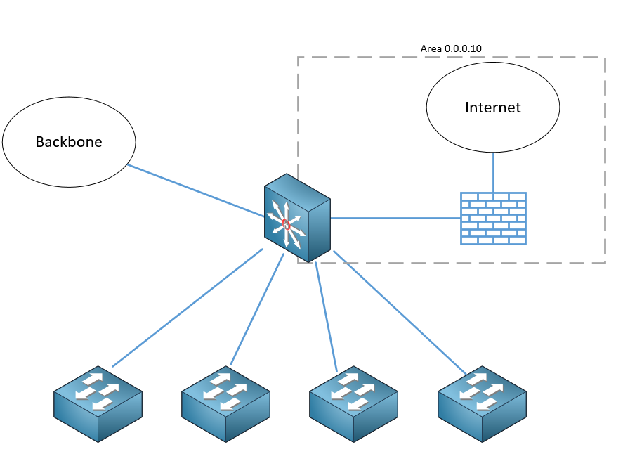

Here is a simple schema of my network architecture :
We have two ospf zone, backbone which announce all company sites, and new zone which will announce site subnets to Edge.
I have created a 2nd area (0.0.0.10). Two equipements are part of this area :
- A summit X450
- A Cisco Meraki

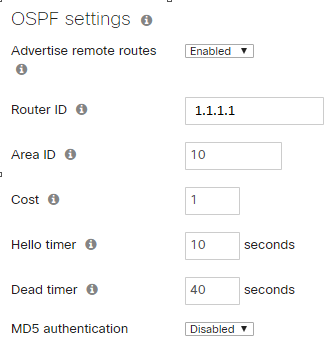

Here is the ospf configuration on Meraki :
Problem is i don't have any routes announced in this new area. I have captured traffic, all i can see are hello packets.
