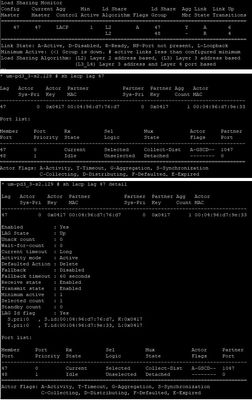

I  have problem with port sharing. As in manual im typing
enable sharing 47 grouping 47-48 lacp -> on 2 switches x440
and after   that im getting on both switches something like that:
I have no idea whats wrong and why port 48 is Detached on both sides
Can anyone help me?

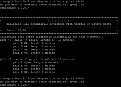

ok, sorry i found the problem - brand new patchcord...
