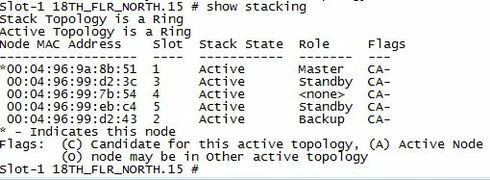

switch not associating in stack as stanby
‎08-21-2016 05:01 AM

From the logs it looks like you need to reconfigure the slot type or unconfigure the slot.

Hi Ashish,
please take a look at this article.
https://gtacknowledge.extremenetworks.com/articles/Solution/SummitStack-show-stacking-shows-slot-rol...

What is slot 4 and how are you making the stack with the neighbors? Are you using a VIM, if yes which one?
