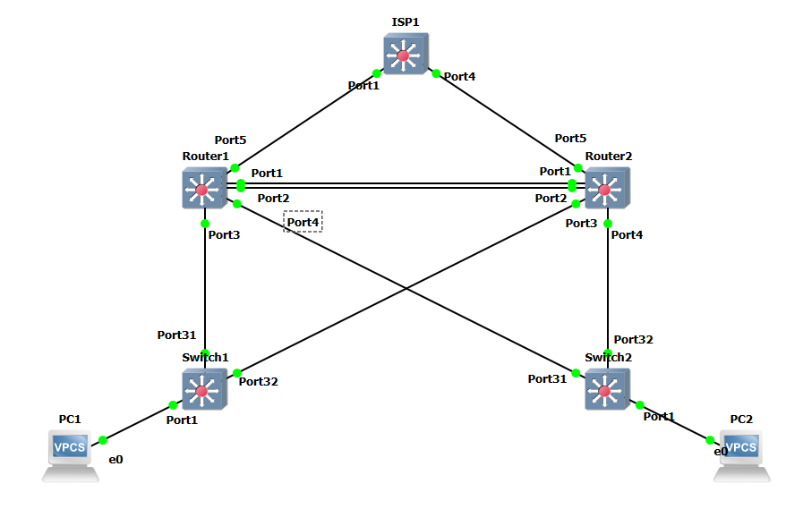

I am designing a redundant solution for a datacenter and am setting up a lab in GNS3 to test MLAG and VRRP and I wonder what the advantages / disadvantages are of using VRRP priority 255 instead of Active-Active. From what I can see, it works flawlessly to put prio 255 in both routers and the advantage is that I do not have to allocate 3 IP addresses per subnet.
It will not work correctly if i have to run traffic sourcing from the VRRP vlan, but I do not see that as a problem.
So my question is what am I missing? Why should i use Active-Active and mot priority 255?

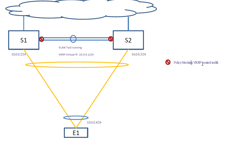

CThompsonEXOS
Generally we see Active-Active in MLAG configurations which can be done via acl on both ends of the ISC link:
entry vrrp-act {
if match all {
destination-address 224.0.0.18/32 ;
} then {
deny ;

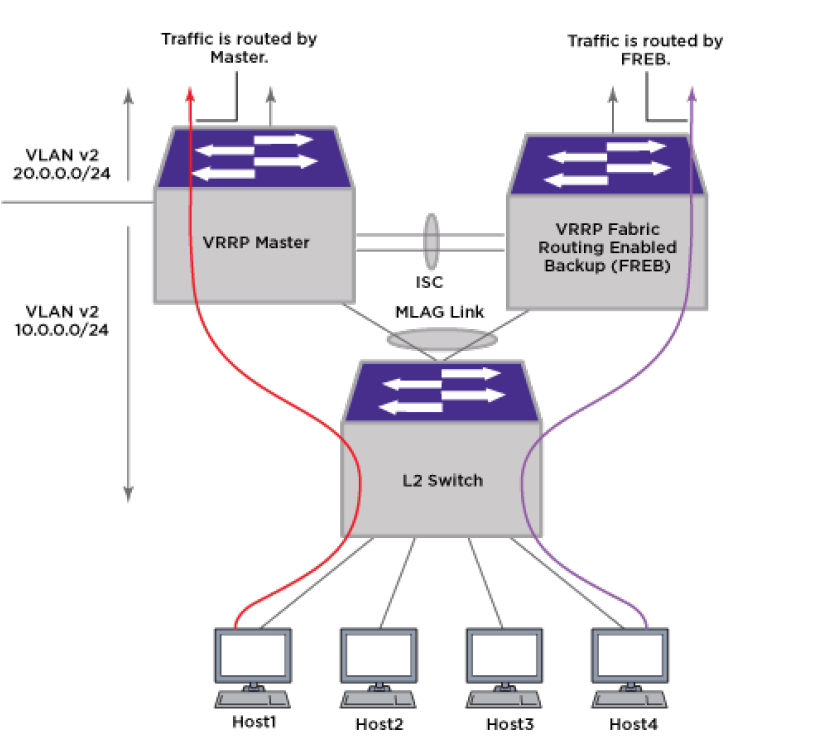

It can also be done via fabric routing:
https://extremeportal.force.com/ExtrArticleDetail?an=000080659
