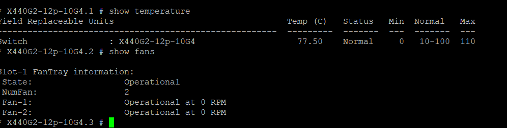

Hello,

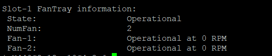

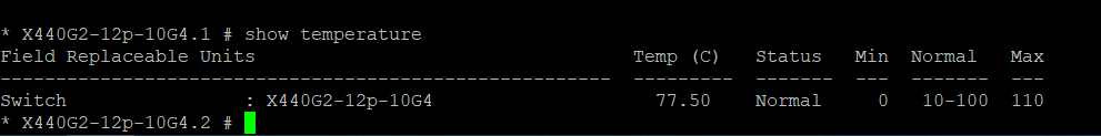

As seen in the image above x440G2 reaches 77.5 celc. But fans are 0 RPM.
Is the device faulty?
​ Thanks in Advance.

The fans come on at 90C on those models:

I got tripped up by this as well.   Don’t feel bad.
As first glace you think the switch is going to melt.
As the KB article that @Christopher Thompson posts, the thermometer is reading the CPU temp.  Not the ambient temperature of the airflow.
