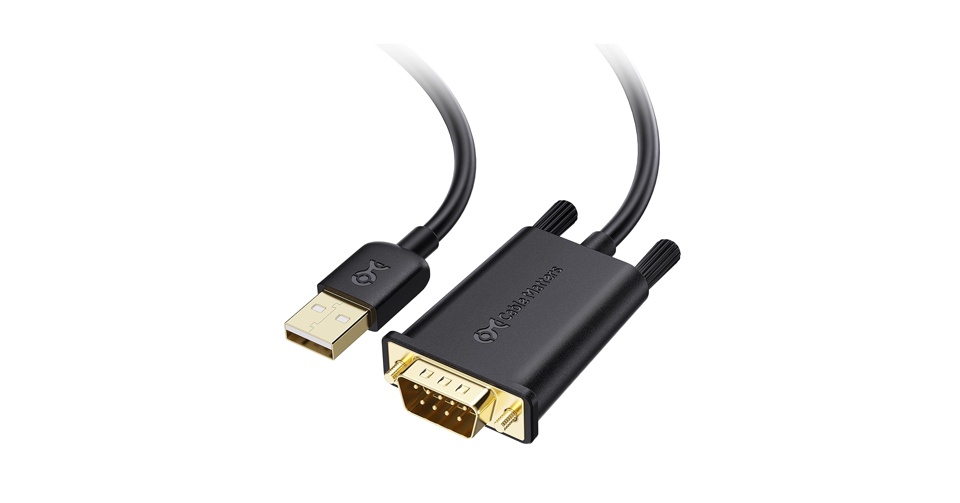

Edit: These are the adapters I am using:
https://www.amazon.com/dp/B07N335QZX
Adapter 2
https://www.amazon.com/gp/product/B0753HBT12
