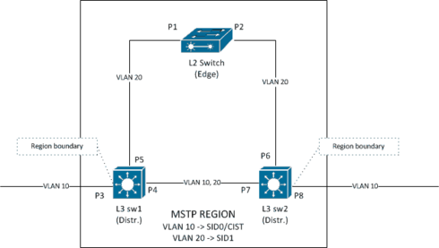

A1) So that diagram and port/SID layout looks correct for how you would want it configured.
Q2) In regards to your second question, are you referring to a specific port in this diagram that you are seeing this? Keep in mind that the MSTI BPDUs are most likely still going to be sent regardless, but the remote device just won't process them as the SID/region doesn't exist (Assuming I am understanding what you are trying to explain). Reason for this is because all ports belong in each SID in the background by design, the VLANs are just required to carry proper MSTP communication between switches so it will functionally speak when required and dropped when not needed/configured.

						Thanks a lot for the clarifications and approval concerning Q1.
You understood right concerning Q2 and I realize that I should have reflected more thoroughly on this before asking. For the people following this thread: indeed, if the hash transmitted in MST BPDU differs between sender and recipient, they know that they are at a region boundary and will ignore the M-records. For the case where the remote side runs classic STP and not MSTP it will ignore the MSTP part entirely as you said, as (R)STP and MSTP are designed to be interoperable. So, it is not an error or a problem that MSTI BPDUs are generated/sent/received as one can see with the debug commands.

Let me give you a simple and concrete example:
Q1) In that diagram, how should the different ports be configured for LoopProtect? I am proposing the following:
P1 LoopProtect SID0+SID1
P2 LoopProtect SID0+SID1
P3 LoopProtect SID0
P4 LoopProtect SID0+SID1
P5 LoopProtect SID0+SID1
P6 LoopProtect SID0+SID1
P7 LoopProtect SID0+SID1
P8 LoopProtect SID0Q2) Oh and in that regard: Why is it that "show spantree debug active port x.y.z sid 1" shows an MSTI BPDU Rx Count and MSTI BPDU Tx Count when the port is a master port? By definition, there are no MSTI BPDUs between regions...?
