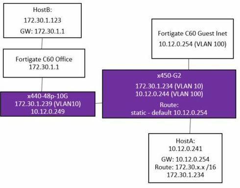

‎11-26-2015 03:17 PM
Hi
diagram enclosed 😉
what i need to achieve is reaching a website hosted at HostA from Hostb
just tell me if you need some more infos!
diagram enclosed 😉
Based on the diagram you have provided, you've told hosts in the 10.12.0.0/24 network now to reach hosts in the 172.30.0.0/16 network. but you haven't done the same for the opposite. Therefore, if you ran a capture on the port going to 172.30.1.1, you should be able to see the Echo requests going towards host B, but the Echo replies not being returned.
‎11-26-2015 01:06 PM
Do you mean that you have the same config in both switches or SwicthA is the router and SwitchB is only L2 ?
Can you show simple diagram network ?
Jarek
Jarek
