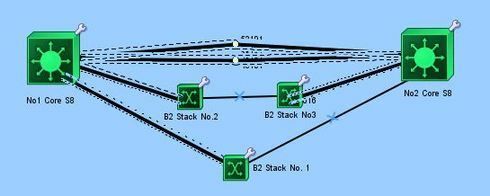

we have a big problem on our network, topology change takes place every hour and in the morning sometimes every 3 minutes.
We use RSTP and BPDU on all edge Ports.
We have 2 Core S8 and about 50 Stacks with B2, B3 and B5, altogether about 150 Enterasys switches.
Both S8 are with 2x10Gbit connected together to a lag.0.1 with all vlans

Our Problem is that the Topology change doesn“t match all Stacks, there are only 17/50 and both Cores which are doing that. We disabled the complete redundancy and it still happens even there where only one stack is connected to both Cores...
How can we find out who causes this Topology change?
