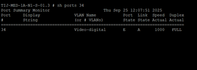

The TV01 is at port 34 of the 128.232 exos switch

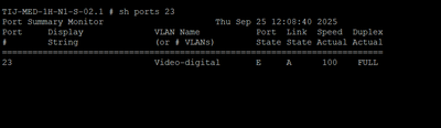

The TV02 is at port 23 of the 128.111 Switch Engine 5320-24P-8X
