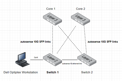

This is a zoomed-in view of our fabric. The network includes more switches, but the graphic shows key physical connections.
the Dell device is only single homed to 1/2 or is there a LAG/MLT trunk with multiple ports? If only one port shuts down and not both, then you could have a unidirectional loop - not sure how a singe port on a Dell device could cause this though, but I suggest to mirror traffic to figure out what is going on.
