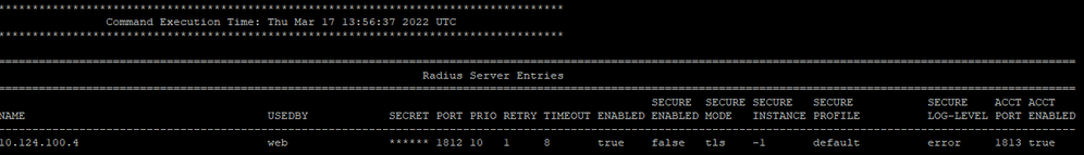

5520-24X-VOSS:1#sho run mod rad
config terminal
# RADIUS CONFIGURATION
radius server host 10.124.100.4 key ******  used-by web
radius enable
radius reachability keep-alive-timer 30 unreachable-timer 30
end​
The strange thing is that radius request are well managed with this config, and UDP traffic on port 1812 reaches correctly the server, but it's not the case for radius reachability...
