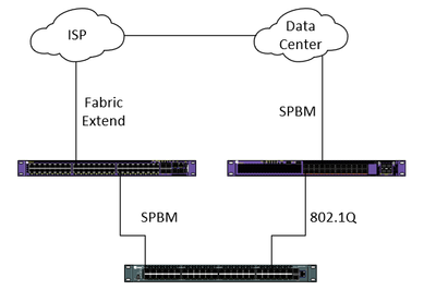

This morning I connected up a redundant link from one of our sites to an ISP. This link is running fabric extend. Shortly after, we had pretty significant packet loss across a lot of our sites. It seems like a loop and I'm guessing it is the fact the the ERS has 1 SPBM port and one 802.1Q tagged port (we intended to convert to SPBM after getting the secondary link up). Here is a diagram of the topology. Is my assumption of a loop accurate or am I missing something?

As WillyHe said, you have a loop.   make that 802.1Q link an SPBm-NNI and this problem goes away.
You are correct Paul, I should have said that also šŸ˜•.

Hello,
  • If the link between the bottom switch and the middle right switch is the only 802.1Q tagged link and
  • All other links are SPBM-FC or SPBM-FE links, then,
  • When you have vlan's connected over the 802.1Q tagged link that also have the same I-SID's configured on both sides of this link, then YES you have created a perfect loop.
regards
