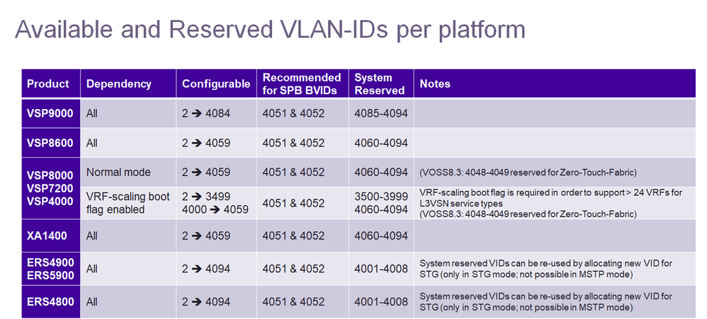

Just compiling a list of possible VLAN ID and I-SID reservations to be aware of.
Reserved VLAN ID’s
If enable both vrf-scale flag and the spbmconfigmode flag, the switch reduces the number of configurable VLANs.
By default, VLAN IDs 1 to 4059 are configurable and the system reserves VLAN IDs 4060 to 4094 for internal use.
On switches that support the vrf-scaling and spbm-config-mode boot configuration flags, if you enable these flags, the system also reserves VLAN IDs 3500 to 3998.
4051 - 4052 Typically allocated to B-VLANs
4048 - Onboarding VLAN

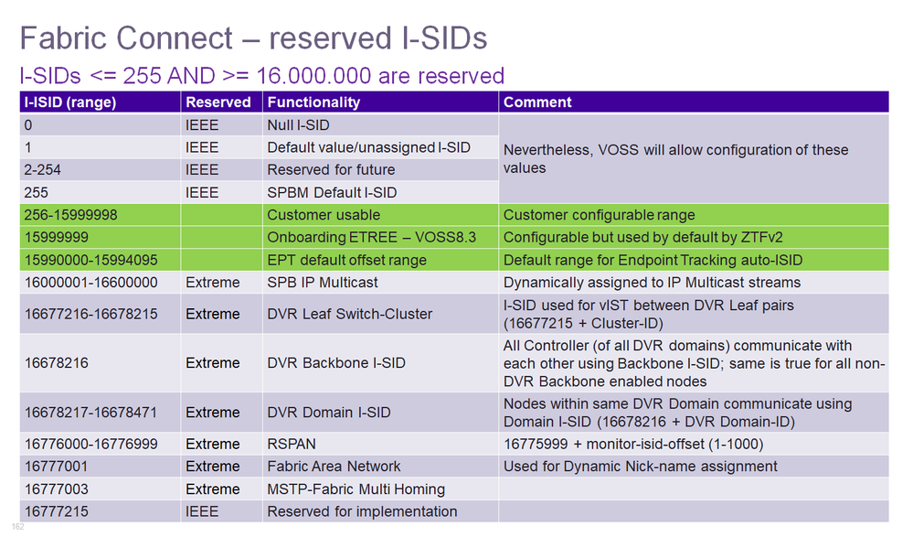

Reserved I-SID’s
24-bit I-SID can take vales between 1 and 16777215
16777001 is used and membership of the Fabric Area Network is announced in TLV 147
Multicast stream is allocated a dedicated I-SID from 16,000,001 to16,600,000

‎01-03-2024 07:41 AM
Just thought I would see if there is an update to the reservations, I ask, as seen the use of VLAN 4047 in relation to SD-WAN. So wondered if there was any others.

‎05-25-2021 10:42 AM
15999999 is used as the onboarding ISID starting with 8.3.

‎05-23-2021 03:22 PM
Thanks Mig, much appreciated.
‎05-23-2021 01:17 PM
Hi Martin,
Here what I have:
